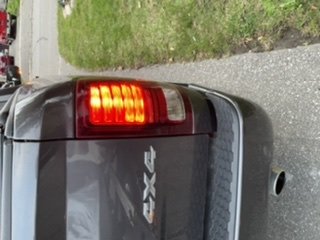

The rear right passenger tail light has three bulbs out when flashing pressing brakes and hazard it the top 3 bulbs in the left from top down I ll attach a pic

On a note when I hit my lock button on the fob those same lights mentioned above work perfectly fine

I would say that maybe your trailer harness wiring might be causing your issue. As far as the rapid flashing goes...Normaly the CANBUS is looking for a particular resistance from that circuit in order to flash correctly. Your hazards should be on a seperate relay from your regular blinkers.
Check your taillights and see if the 3 that are not working are incads or leds. If they are incads and are burned out that may be your issue with the quick flashing

I called the dealer on my vin and was given this part 68093080ac was told I need to replace the entire assembly I did check the trailer and had resistance I did see the 20amp fuse was burned so I replaced it, while at it I relaxed the 30 amp also as it did give me an issue a while back
Checked the harness and didn’t see power to two of the connectors I’m hoping the light being burned out sorts it out ordered it aftermarket for 289 dealer for oem was 500
