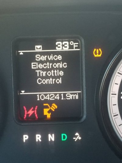

There is a shot of the ETS light.. It comes and goes. The last few days have been a nightmare with this thing. It has literally been a great truck up to this point. And as soon as the warranty runs out, it give me major issues. Lol. 373caf4cdb94f0fc2f92c14e17184bc5.jpg

Damn, this really sucks Donelam. Hopefully being only 4K over RAM will be a little flexible. I really hope your truck gets taken care of by RAM if there is a major issue. I don't want to derail your thread, but did your 2014 truck ever intermittently belch blue smoke on startup? Only 47,600 miles on my 2014 and it'll still belch a cloud of blue smoke randomly on start up. Sometimes won't happen for a while then it'll do it 3-4 times a week. Service dept. hasn't been able to replicate it yet.

Have you had a lot of moisture or rain recently? Reason I ask, is I had the same issue with my ETS light when we had about a week and half straight of rain. The issue cleared itself up afterward it stopped raining. I hope you the best.

Had some rain, but even when it's dry it just randomly comes in. Crystler is being a pain. Won't give me a straight answer to save their life.
