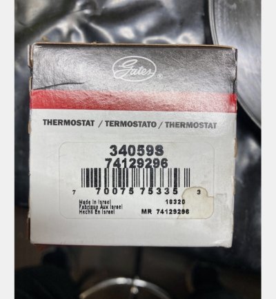

I installed a Gates 190 degree couple years ago in my 2016. Runs low 190’s in summer and high 180’s in winter. Also deleted the shutters. No issues. IMG_2694.jpeg
