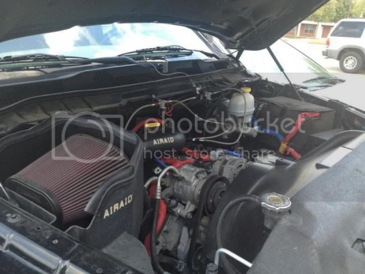

Alright first off I am now currently spraying a 100 shot in my 2010 Dodge Ram 4.7L RCSB. This advise is based off a 100 shot and only a 100 Shot.

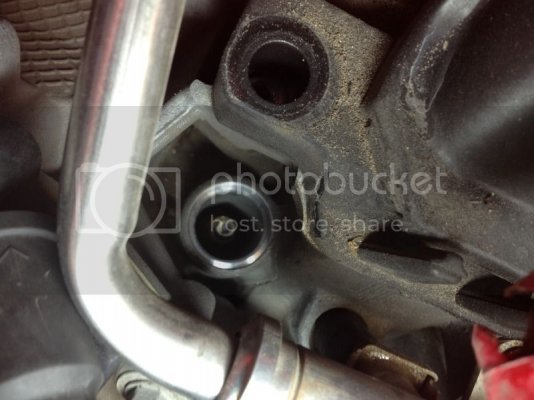

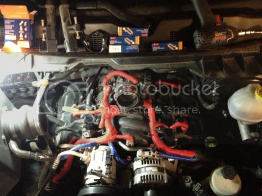

First I purchased all 16 Plugs. And installed. For this you will need a thin wall socket for your sparkplugs. I grabbed one from O'Reileys. I posted a picture with the correct measurement it should be.
Denso 3381 K20HR-U11 Nickel Spark Plug
Exhaust Plugs
Intake Plugs
Next I changed the Tstat to a 180 Performance Tstat
Next you need to get a custom tune for specifically a 100 shot of nitrous. I had my tune made by Sean Powell @ HEMIFEVER TUNING

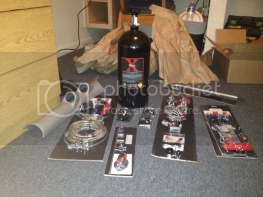

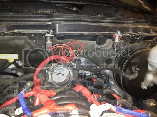

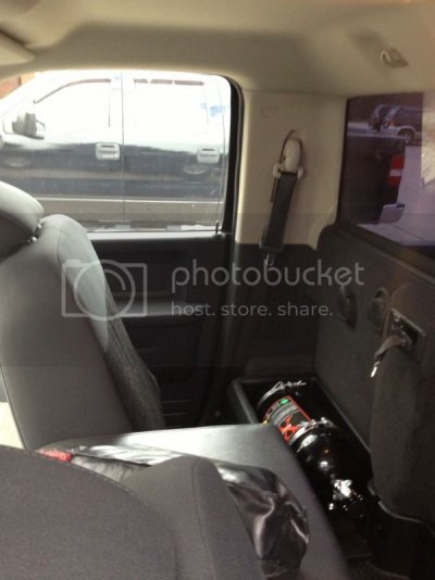

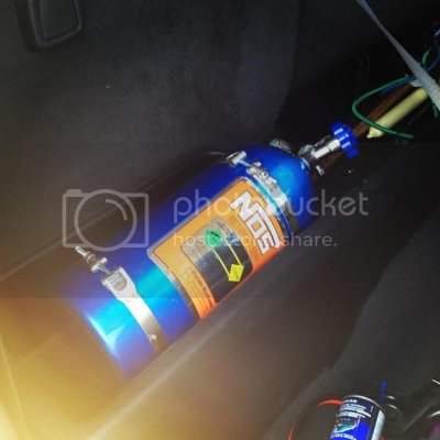

I then installed the nitrous kit along with a purge kit and fuel pressure safety switch. Bottle heater is left to install.
4.7L on Nitrous - YouTube
A race against a 12 5.0 regular cab F-150. His mods, CAI, exhaust and tune. 14 second truck.
My mods, CAI, exhaust, nitrous tune, 3000 stall on a 100 shot
