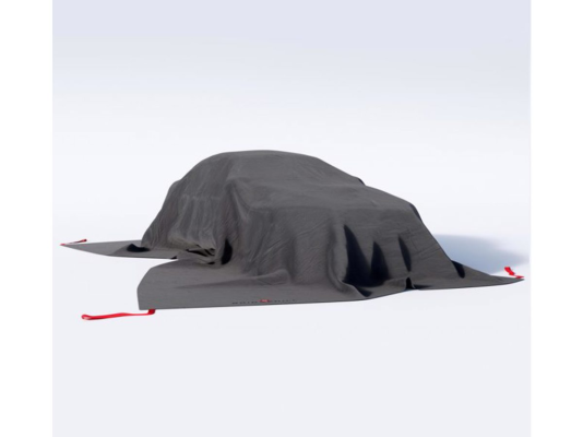

Being as Lithium Batteries are so difficult to Extinguish.
The Battery has to be completely wrapped in a special Fire Blanket, when it is still in the vehicle, that means that the whole vehicle would have to be wrapped to cut off Oxygen.
That would mean the race track could be unusable for hours.

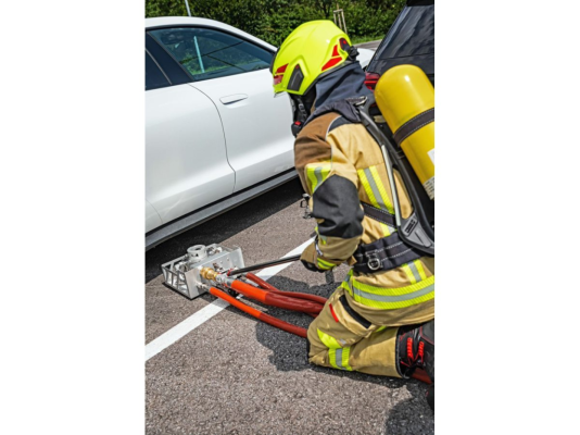

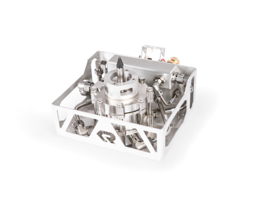

The other way is to push this under a vehicle, so that it is under the EV Battery.
Then Puncture the bottom of the EV Battery to drain the fluids

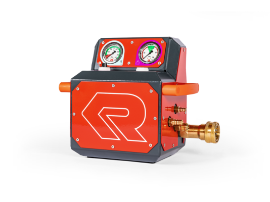

this is a control box, for the above unit

Is this ad from Temu? EV’s aren’t powered by one big wet cell battery. If it were the fluids are corrosive and or caustic so now it just created a hazmat situation on top of whatever else is going on.
The batteries are made from hundreds of individual cells. There is a small amount of fluid in each more like a gel. That thing does not seem useful as the gel won’t drain and there is no practical way to puncture hundreds of them in an emergency situation. EV manufacturers do not recommend puncturing the battery.

The products that i posted as an example for Vehicles involved in an accident, that have Lithium Batteries, did not come as an ad that came from TEMU.
It came from a big German outfit, that submitted it to some Fire Fighting Org.
Name of company is
Rosenbauer​

So the device does not puncture the battery to drain fluid. It punctures the battery so water can be injected. During the puncture operation the videos show a few cells igniting. However, the videos they show are brand new vehicles sitting on a flat asphalt surface. Maybe if the EV spontaneously combusts in a parking lot it might be useful. I have yet to see a wreck that looks like anything in the videos.
A recently wreck vehicle laying at an angle in a ditch is probably not conducive to using that device. Also, after a wreck there may be an unknown number of compromised cells in the battery. Compromised lithium cells react violently with water. Again, probably not a good idea to inject water into a closed metal structure causing a bunch of compromised cells to basically explode. IMHO, this device would need more testing on actual wrecked vehicles and certification laboratory testing before being deemed safe to use. In the US it would need to be tested by UL, SEI or other such testing organization. Also, NFPA would probably need to set some standards for devices of this type.

I did find some videos, after i posted in here.
I did wonder about what stage of testing they were at.
The test vehicle was on flat ground, all 4 tires fully inflated.
No obstructions around it, like a tree laying across it.

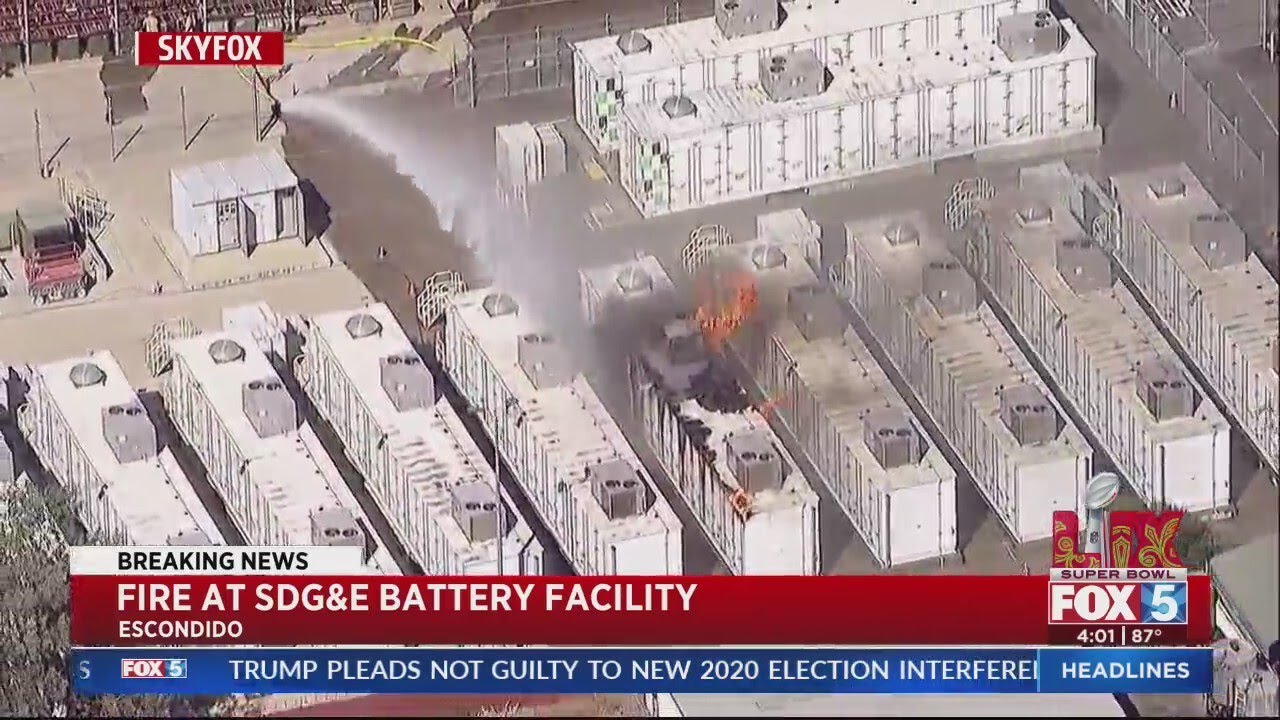

The Power Companies Lithium Battery structures,
possibly could be a Modern Day Lithium Battery Sub Station,
looked similar to modified SEA TRAIN containers, they had a Fire in one near here, they said that it would burn out within 2 or 3 days
