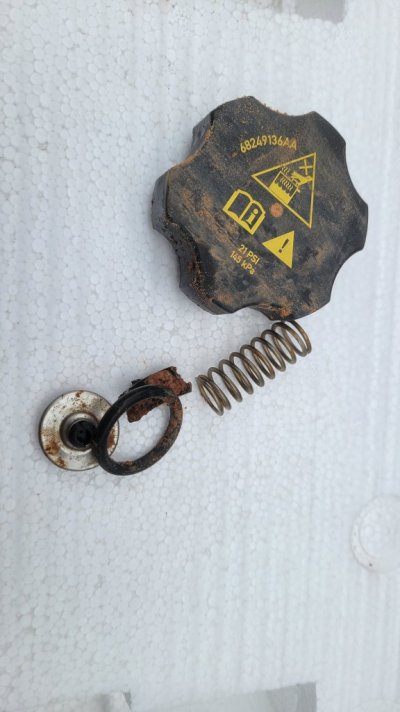

This isn't part of my truck, is it?
khigh
Jul 16, 2017
33
22
Georgia
3.0 EcoDiesel
2015 Ecodiesel.
Found this under my truck by my barn. A place where ONLY my truck has ever been.
Clearly it's to a radiator or coolant tank. Mine is in place as shown, as well as all other caps.
My working theory is that a tire slung it in to my undercarriage on the road and it fell out at home.
I hope I'm not overlooking something!
Thanks for looking,
Kevin
Looks like the pictures are in reverse order of how I intended.
Docwagon1776
Mar 16, 2012
4,758
10,198
Midwest
2012, 2021
5.7, 6.4
It is from a 2014-2020 Mopar from the part number. Coolant recovery cap, but yours is in place in the photo.
You ever change your cap and drop it? Or if you haven't had it since new, did the last guy?
crash68
ACME product engineer
Mar 20, 2016
12,369
21,539
3.0 EcoDiesel
well it does appear to be the correct part # for the EcoDiesel, some of the OEM caps would get stuck and break apart when removed. It hard to see exactly but the one on the truck looks like an aftermarket one.
The coolant tank looks low in that picture, the level should be slightly above the seam.
Ken226
Mar 12, 2017
2,318
6,011
Washington State
Looked up the part# and it's the correct part for your truck. But, obviously your cal is not missing.
My guess is that in the trucks past, whether at the factory or in a shop somewhere, someone dropped it into your engine well, couldn't find it, then installed a replacement. The lost cap then went for years long ride.
Untill it recently fell onto the ground, under your truck.
mdc1990zr1
Feb 10, 2019
557
1,182
Conshohocken, PA
2015 Ecodiesel.
Thanks for looking,
Kevin
View attachment 558919View attachment 558918
May yours was replaced at some time and when they did the exchange the original fell somewhere in the engine compartment and fell out later. Happens all the time with nuts and bolts.
K
khigh
Jul 16, 2017
33
22
Georgia
3.0 EcoDiesel
Cap off your coolant filler bottle or radiator, depending on coolant system the eco diesels have. The 21 PSI is the give away. May be the cap was replaced and the old one left in the engine area by mistake..
You know what? Got me thinking.
Changed the radiator earlier in the week.
The truck was 2 years old when I got it. A previous overflow cap got down in there years ago and came dislodged installing the new radiator.
Whew! At least I can drive around with peace of mind now that I don't have something unoressurized.
