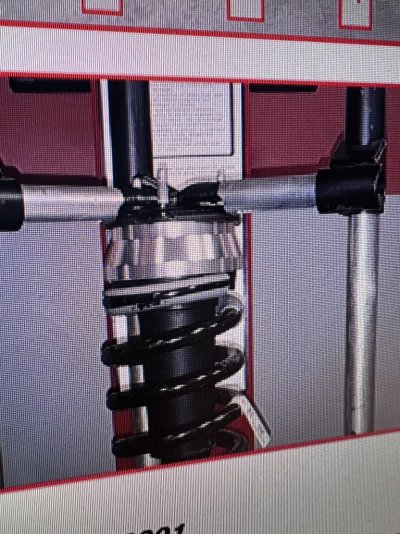

36F56309-A4FC-4D26-9132-8B1B9F64E0BF.jpegThis picture is from readylifts instructions. Surprised to see how much different that spring sits in there vs the 4th gen. It appears yours is correct.
The bird chirp sound you are getting is most likely the strut top bolt not tightened properly and it’s just loose enough to chirp (metal on metal)

It didn’t look like the rubber coil isolator was installed but when I zoomed in on it I could see a sliver of it. I believe you are good to go
