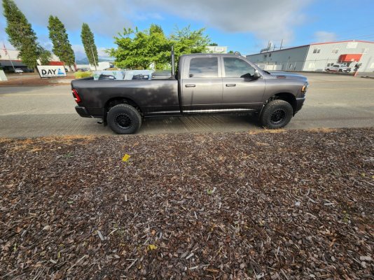

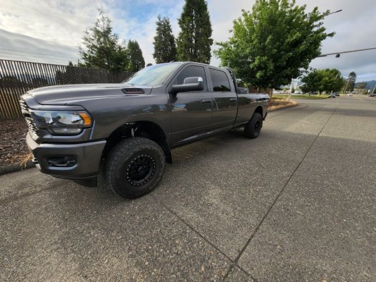

After another couple thousand miles the have settled in. It's still a little bouncy here and there but getting better each week. I met up with another member from the forums @G. Mcpherson and he pretty much has his front end set up like mine and rear air bags with thuren fox 2.0. The difference from stock rear springs to thuren is noticeable and a lot softer ride. I installed the thuren shackles and put them on the 1/2in shackle settings. Compared to oem spring and shackles it will raise the rear 1in. On road you get some better performance and off road is where you really can tell the difference from stock. With these spring you will lose payload and will want air bags if you tow or haul heavy. It's hard to say if it was worth the $1200 for the upgrade as there is a lot of good but negative points as well. Now the difference from thuren fox 2.0 compared to thuren king 2.5 is a big difference as the rebound is a lot smoother.

It will make the ride better than stock. I read the same review I haven't done it because I don't want to lose even more payload. The springs are getting better everyday. Follow thuren torque values and not oem. Oem calls for 340lbs on front spring eye bolt and it caused these to bind. Use lots of good grease as you assemble and lots of grease after. Rear thuren shackles makes a lot of noise when not greased. With thuren shackles on 1/2in lower setting it will raise you up 1in over stock.

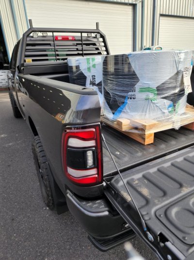

Had to go pick materials up 1.5 hour drive each way. 2 coils 2,540lbs each had the air bags with 90psi in them. It was pretty damn stable going down the road. Turning and going off camber you knew you had that much weight in the bed. I have my headache rack and cross over tool box total 500lbs.
