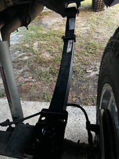

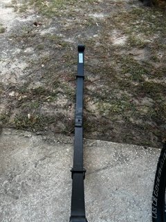

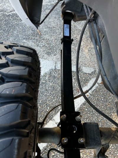

finally finished up last night. I went from stock to, stock springs and a 3-inch block, then to a 1-inch block and a 2 inch add a leaf (better but rode like crap) and now finally my Skyjacker 5 inch Soft Ride springs. what a difference. That nose high look (NOT SQUATED) vanished and the truck leveled off. I swear the 37's look to small now. First pic is the add a leaf and small block and the other two are the new springs.
to this
