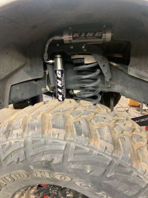

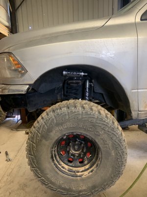

Overland will straight up party. I’ve had mine for two years. Just upgraded to king 2.5 and added in the rest of the goodies. You can’t beat the overlands for the price. I’ve crawled with em and done some jumps. Nothing super crazy but more than I prolly should have with em. You won’t regret it

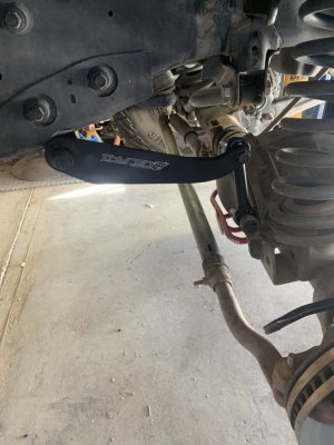

i did the 1/2" leveling springs, rear springs, front/rear trackbars, king steering stabilizer and fox shocks. Very happy with how it turned out and the handleing was vastly improved on/off road. I did the 1/2" because i use my truck for hauling stuff and didn't want the squat to be worse than it is. King shocks would be in the far future for me.
