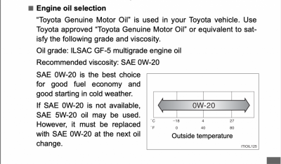

As a comparison, I had a look at the service manuals for other truck brands; just to get a comparison. Here is the oil recommendation for the Chevrolet Silverado - a truck that seems to fair better in reliability surveys.
I found it interesting that they gave different oil recommendations for different engine sizes. Why did the 6.2L have a different recommended oil compared to the 6.6L?
Now to a truck that is known as the most reliable truck.
