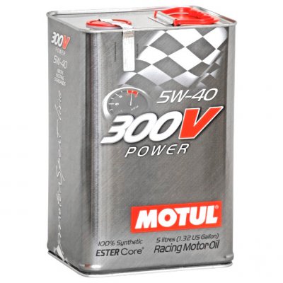

@Burla What do you think about using Motul 300V 5W40 if Redline is not available? That was one of your recommendations when we had issues getting Redline some time ago.

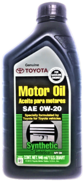

In addition.. It appears that Toyota brand oil has quite a bit of Moly as well. Perhaps that is the secret to their top rating in reliability. LOL
