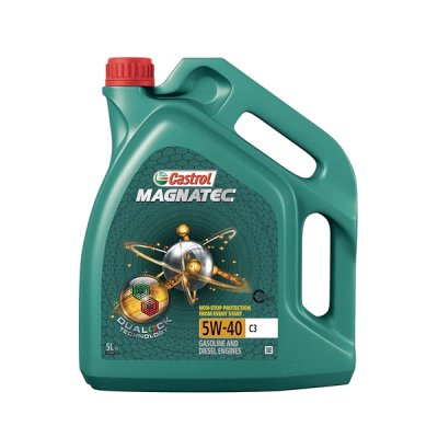

So, it isn't this one?
I'm just going to stick with Red Line 5w/30. My HEMI is doing just fine using that and the Royal Purple 20-820/AMSOIL EAO11.
Thats the one to use the one you pictured. That hpl is the one he can get in dubai

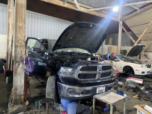

Thank you @Dodge 1500 4X4 & @06 Dodge.
I instructed the mechanic to use Redline 5W40 right now after the rebuild. We know it is available here and it is a proven oil; although at quite a premium compared with brands like Castrol. Lubegard is not available here locally, neither is Pennzoil. So using that combo is out of the question; unless I order them.
The plan is to use whatever is locally available and cost effective to save a bit of coin in maintenance; hence why I was looking at Castrol Magnatec.

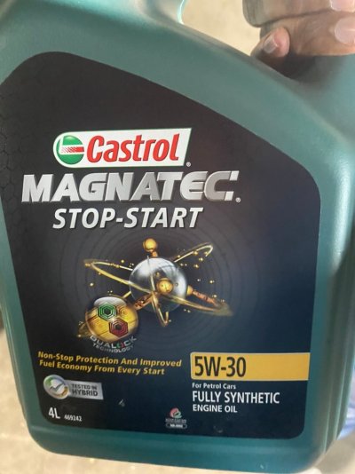

Most of my commute is in the city, in traffic and I do run the MDS, so I was thinking that the Magnatec Stop Start would have been a good option.
If no one else has run this oil, I suppose I could use my truck as a test subject, but having spent so much on the fixing the tick, just using Redline seems like a no brainer.
I was reading the Synthetic oil thread and there are worries about Redline changing their formula. HPL is available in the market, but at a higher price than Redline. We also have Motul 300V, and it is the same.
My brother's 2004 Durango ran fine on just normal off the shelf oil and never had the tick. It had the MDS and it ran for about 290,000 kms before we sold it. Its manual called for 5w30 so that is what it ran from the beginning.
I know the Hemi in my 2014 Ram isn't really the same and had quite a few updates since then, but I figured that much of the design remained close to identical.

See if you can buy some gas/diesel oil, I know some say BS but I can say since 1980 when I went to gas/diesel oil I have never lost an engine or had oil related problems...
What oil do you run on your engine? Looking at your profile and seeing that you don't have the 5.7 V8, guessing not Redline or PUP/Lubegard combo.
Castrol Magnatec is something that runs on Gas and Diesel engines. Hence why I was looking at using it. The info on whether it being a full synthetic is a bit hazy. At best we can say that it is a blend. Castrol Edge is the full synthetic and has the same "intelligent molecules" as per their marketing goes; although probably not as much as Magnatec does.
The trouble with either is that the moly content is about the same as PUP. This is what makes me hesitant on using it. I would probably have to add Lubegard to it.
The goal is prevention, now that the tick has been sorted out mechanically. My idea was to use an oil that is readily available here in Dubai and not have to use any extra additives, etc.
That is the general idea. If we can use something that is cheaper than Redline, then even better.
The hope is that Castrol Magnatec would be up to the task. My idea was to run 5w40 now for the first initial break in and then 5w30 in Winter and 5w40 / 0w40 / 10w40 in Summer & change it every 7000 kms.
In order for me to go ahead with it, I just need someone experienced in using the Castrol oils to weigh in this.

I decided to take the plunge and do some testing with Castrol Magnatec.
Let's see how it goes.
From what I know about this oil it looks to be a good oil and the 5w40 will cover a wide range of temps, I recall being told back around summer of 2014 by a Dodge tech that one of the reasons of them going to thinner oils was due to engines being made with small oil passages and being you have a 2014 you should do okay using 5w40 oil. I read above you plan on going to 5w30 winter, from what I read the 5w40 has a lower pour point than the 5w30, so why you would switch to 5w30, I didn't think it gets that cold in the UAE...

@06 Dodge It actually does go to about 14.C or colder in some parts of the country.
I don’t want to go too thick during the cold season.
If that is 14C and not negative -14 then that's equal to 57 degrees F not all that cold in my book as I'm use to sub zero temps for winter. For 5w30 or 5w40 oil the cold winter weight for both oils is 5 not 30 or 40 weight. Also 5w40 oil has a lower pour point then 5w30, I recall 5w40 was -44 below zero compared to -39 below for 5w30. BTW I have personally used 5w40 oil in cold temps to -30 below zero or -34.4 C and in a few cases colder temps but then when it gets colder than -30 then its time to use oil pan, block heaters or both :Big Laugh: Oh if it makers you feel better to use 5w30 for winter then by all mean use it, its your truck not mine...
