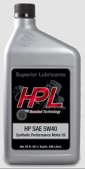

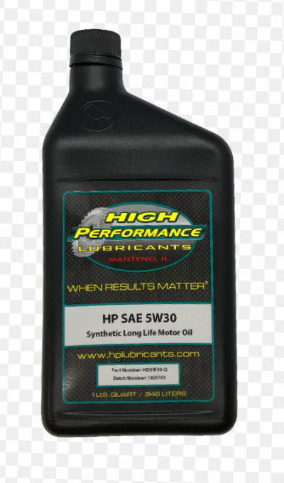

I was reading the Synthetic oil thread and there are worries about Redline changing their formula. HPL is available in the market, but at a higher price than Redline. We also have Motul 300V, and it is the same.

@Travis8352
Castrol Edge would cost me about 108 USD.
Castrol Magnatec would be 73 USD.
Redline would be about 160 USD.
HPL is about 168 USD
Mobile 1 European blend isn't available. We have these..
Both of which would cost about 122 AED each
* The prices are approximate based of Amazon pricing for a quantity of 8 Litres.

Id use that oil with confidence! Your best bet is either that or redline 5w30 based on your location. Is mobil 1 europen car formula 0w40 available? Thats a great oil at a cheaper price to. Cheap in the usa i dont know how it compares where you live
So, it isn't this one?
I'm just going to stick with Red Line 5w/30. My HEMI is doing just fine using that and the Royal Purple 20-820/AMSOIL EAO11.
