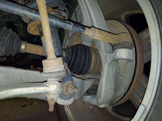

So noticed my front right tire is worn already to the wear bars almost. All other tires are not even close. Looking under myself I notice one tie rod looks funny and the other doesn't. Still learning this truck stuff and not sure if its a cause or not... Thoughts? kN9xycS.jpg0316u65.jpg

I probably just needs aligned. Almost the same thing happened to my truck. I didn't notice a difference in the steering, but one day I just happened to notice the inner tire was worn past the bars.

Needs an alignment badly. The tie rod looks normal to me, but those are easy to change if/when the time comes. Get a good shop align that thing, you are getting worse traction, fuel mileage, and tire wear being that far off!
