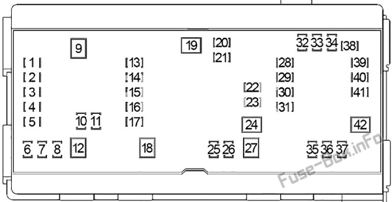

I have a 2008, 1500, 5.7L, 4wd, SLT. Engine wouldn’t start. Would try to catch, then just crank. I did not hear the pump priming the system when the key was turned on so I dropped the tank and replaced the pump.
Worked for a day (on a 200 mile trip), then the same issue again. I assume it’s the fuel relay in the TIPM and would like to test/bypass it before I relinquish my first born for a new one. But, I’m not finding anything video or diagram wise for this style box. The owner’s manual for the fuse layout is vague in it’s descriptions. Any help is appreciated, or a free match with tinder (may be more satisfying).

I use a kit essentially like this one...
I have a copy of the 2008 DR FSM or Factory Service Manual you can use to wire up the relay and bypass the TIPM.

I appreciate it. I have had some random electrical issues that point to replacing the TIPM. I have a used one arriving tomorrow, same year, same P/N and with 240,000 less miles. Hopefully that will fix it. If not it’s back to the troubleshooting board.
