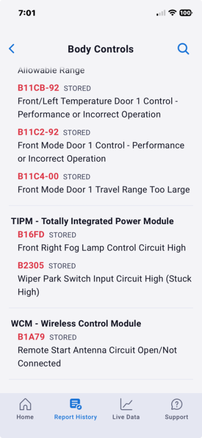

I would love to help, but realistically, with the detailed info you provided, there are quite a few potential causes. First step is to put an OBD code reader on it and pull all codes. Then work from there. If you are going to be really short on time, best bet would be to take it to a well trusted independent repair shop and have them track it down for you. I know you already tried this but realistically, until they can replicate the issue, it will be very hard to isolate the cause. Something is drawing the battery down, but not every time.
The one thing you can try is have her put it on a charger every night. If it always starts the next day, that eliminates a whole raft of things, you just have to figure out what is sporadically flattening the battery. Alternators work or they don't, they rarely fail sporadically. Best of luck.

I would clear the codes and re-check after a coupe days. Those could be errant codes from before the battery, or right after...
