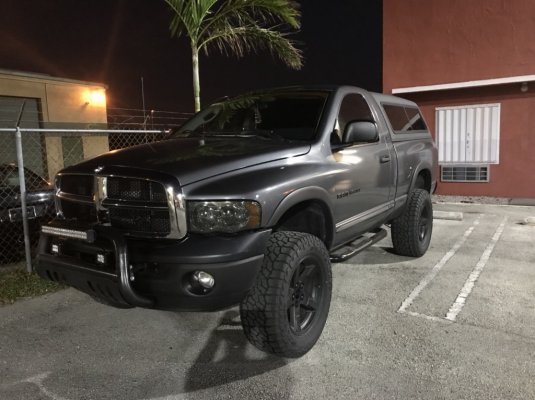

I have a 2wd with a 7.5 lift falken wildpeaks at3 are awesome on trails there all around one of the best there even beefier than the nitto I think. I have 35’s you don’t want nothing smaller than 35 with that much lift it won’t look right I speak from experience lol
