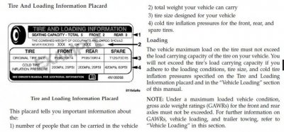

Check the label on the inside of the driver door, it will tell you what the tire pressure should be COLD. From the 13 OM "The proper cold tire inflation pressure is listed on the
driver’s side “B” Pillar or rear edge of the driver’s side door."

I would not over inflate tires. Use the recommended pressure for your vehicle weight which is printed on the information placard on the door.
Here is quote from the NTSB: "a tire that is over inflated shows more wear along the center width of the tire than along its edges. When your tires develop uneven tread wear, it shortens the overall life expectancy of your tire. An overinflated tire is stiff and unyielding and the size of its footprint in contact with the road is reduced."
Just sayin. Your truck, your choice.:peace:
