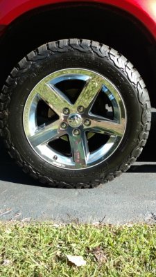

Ludville1
Jul 23, 2018
508
889
Michigan
2009
5.7 Hemi Sport Crew
I’d be interested to know what the manufacturer says about what you should run those tires that, if BFG was just trying to be way too overkill with the all-terrain‘s that I used to have on my truck that were load range D that they said I need to be running at 55 psi with a minimum pressure of no less than 50. But then again, I don’t know if you’re 10 ply tires would require even a lot more pressure than that or not, or if you’re safe to run that lower pressure.
And as far as everybody saying your truck doesn’t ride like a truck with those 10-ply Yokohama‘s, I can tell you straight up that my half ton limited with those eight ply BFG‘s on there and air ride, they made my truck ride like a tank. I don’t know, maybe it’s because you have 17 inch wheels and I’ve got 20 inch wheels but even running those BFG is all the way down to 39 pounds of pressure right after I got them before I learned that was dangerously under-inflated, they still rode fairly smooth but they weren’t near as smooth riding as the GoodYear SRA’s or my Michelin Defenders I have on it now.
I have the BFG K02's, and that is exactly what the BFG tire rep told me to run for pressure.
