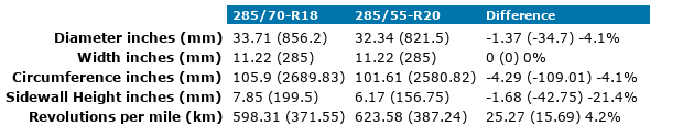

I was thinking of swapping the stock tires and rims on my 2024 Rebel (18) to. 20 inch rim from a 2022 Laramie
The rim fit won't be a problem, but the tire size is different.
You would probably want to up the tire size on the 20" rims to a 285/60/20 to match the size on your truck now.

Stock for stock, you're looking at over an inch difference in diameter, smaller for the Laramie. That translates to a wheel speed change and reduction in ride quality. Like crash68 said, you'll probably want larger than OE Laramie tires. Tire ply will also make a difference in ride quality- more plys=stiffer sidewall. Most stock tires are not LT (C,D,E,F). Things to consider.
