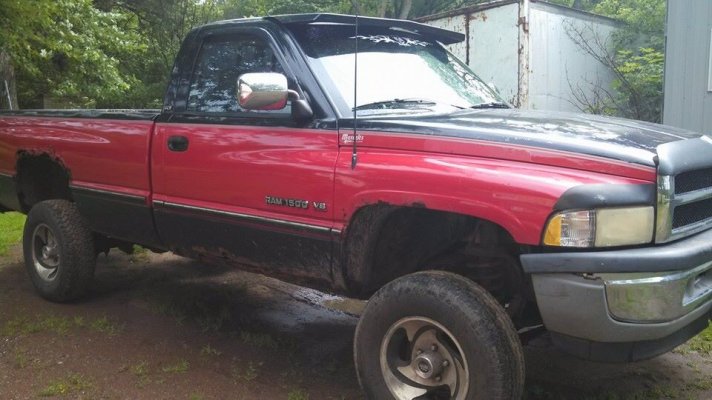

As some of you may know I totaled my truck a few months back... Bought a 2010 impala for a daily commuter.. But today I just recently purchased a 1995 ram 1500 reg cab long bed with the 360..
It's not in amazing condition by any means. But only 129k miles. Needs a alignment bad cause everytime you hit the brakes it pushes you to the left or right bad like scary bad. Otherwise going straight down the road the wheel is half way towards the right haha.
But I look forward to learning and fixing this truck up some to keep her going. Any things to look for with this generation? Things I should do right away no matter what? It also has a 3inch lift installed.
Thanks and glad to be back on the ram forum!b1be75fc20bb662a65292cd182a3fb81.jpg

I think 285s are a good sized tire for these trucks just my oppinion though. Might want to determine whether or not your plenum gasket is leaking. Theres a read up in the engine + performance section. The best way to tell i think would be to check for other vacuum leaks and see what rpm you're idling at when i fixed my plenum gasket i went from 900 rpm to about 700 at idle but ive got a 5.2 so it might be lower or higher you never know... Looks like your truck has about as much cancer as mine haha gotta hate that crap. I love that visor though! Also id get new wheels with your tires, i dont like those much.

Yeah I was thinking 285s and the visor is nice looks good. Yea the rims will go if I find a decent set for cheap ..
