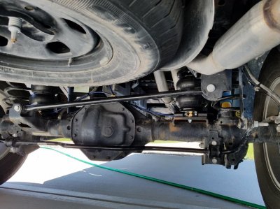

There looks to be nothing hanging down below the pumpkin.
Your photo shows exactly what I'm talking about! Look how much clearance is lost under the AXLE (not the pumpkin) because of the sway bar and shock mounts. All of that hardware could have been moved up parallel to the axle axis - gaining about 3" of ground clearance (equivalent to 6" bigger tire).
Yeah, I know, it's a pickup truck not a Humvee. Still...

Yes but nothing is below the pumpkin , no sway bar would be better but the shock mounts are close to the tires so I would not think you would really hit them on much.

I am not missing any point, what you described your truck being able to do it already can in stock forum..lol
Move the sway bar and shocks up and the pumpkin is still going to hang you up just the same.
I can understand the sway bar but the shocks are so close to the tires I dont see them cause problems except once in a blue moon.
