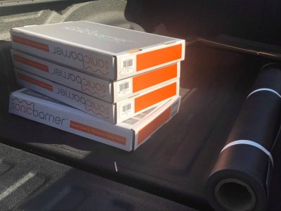

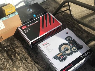

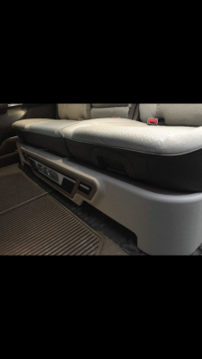

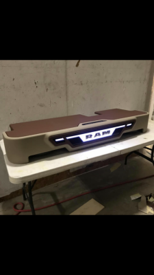

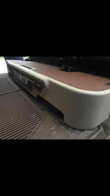

CBC40A3E-965E-466E-A13D-1798CFC4DE3F.jpeg 25100E44-D30B-4FCA-A0AA-408D21693E2A.jpeg 9AF559FE-6427-441D-B7D9-11D115550AD9.jpeg F61F6149-DE09-41B2-A04B-23828D0D37C8.jpeg C7D6AB6E-1221-424F-8244-1F7C869E764B.jpeg i Have the HK with the 12” screen. Over the weekend I ended up removing the factory amp, sub, door and dash speakers. Added couple new amps, subs, and added a focal flax 3way system using the factory location. Interface by maestro/dsr1. Used all factory locations for a stealth install. The amps are even hidden behind the seat. Will post pics of the box with 2-13tw5 when it’s ready this week. If you look closely you can see he amp through the vent holes where the factory sub was located. I’ll be replicating the vents on the other side.

My God! That's a beautiful box! Are the seats still able to recline?
B
Bcovish
May 14, 2018
112
74
Bastrop tx
I'd like to fly ya out to raleigh and replicate system for me . Always worry about hacks locally.
Yes. You need to do your homework for sure to find the right shop. It took 3 of us 2 days with a total of 60 hours to finish. Luckily we were all experienced enough to tackle different parts of the install.

Who made that box? Is it custom or is it a shop like MTI aquistics?
Also do all your bells, chimes and sensor alarms still work properly as well, especially with no rear speakers?
The box was made by a shop in New Braunfels TX...Audiosource. No. I did not retain all the alerts with my set up. Knew that going in. This is going to be a competition truck so the reason for the rear delete.
