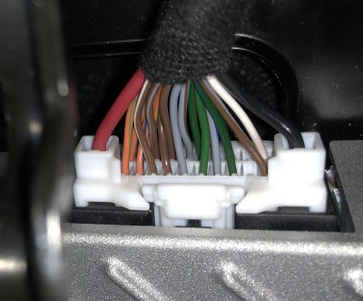

I've been trying for over a month now to get my stereo going.
I have a 2019 Dodge Ram 8.5 display with the base 6 speaker system. I've been told that device under the seat is an amp and I've also been told it it's just a noise cancellation device. Somehow I need to figure out what it is and how to deal with it in order to upgrade my stereo system to awesome. Any help would be appreciated.
The DSR1 says it is compatible with the 2019 rams. The PAC AmpPro is not there yet. I've been trying to get the DSR1 working. It sounds like they've ironed out the problems with the 9 and 19 speaker versions, but I'm batting my head against a brick wall on the 6 speaker system.
Here is a picture of my main harness connector. From pictures I see from the Alpine system and comparing the schematics, it looks the same. I have 2 harnesses going into the amp, the Alpine has 3... but since the DSR1 only uses the big harness where the important stuff is for a full system replacement.
I can't imagine that the 8.5 display is different on any of the speaker builds. I'm thinking it is that amp that is different. Maestra has said that isn't an amp, just a noise cancellation processor. I'm not convinced.... I'm hoping it's an amp and that I'm getting fixed amplitude signals from the radio from different sources (audio, NAV, car warnings, etc) and this does some basic DSP--taking commands from the data bus and mixing/controlling the tone changes, fade/balance, NAV and Siri commands to front left speaker, etc.
If so, devices like the DSR1 and the PAC AmpPro will eventually work. If not, dang--my stereo upgrade options would be limited limited. I've been working a lot with the folks at Maestro and Rockford Fosgate without much luck. They don't seem to be interested in making their product work for this build and I've been told to just go to Universal mode. But I think all the data is there and I think it's possible and will work tons better in the Maestro mode. I just need some more info to back up my suspicions... the 6 speaker system has an amp that functions like the alpine system (but with less power and outputs). From the schematics and looking at the harness, this appears to be the case.
Any pics, schematics from the radio, expert input, or total off the wall speculation is appreciated! Also, what other options do I have? I have my vehicle wired (new speaker wire, amps, etc) and ready to go if I can figure this part out. I just need to pop in the new speakers once I have answers and I'm rocking... (I'm keeping the factory system going until then).
Right now, when I hook up the DSR1 I get audio for about 3 seconds from the front left speaker, and it fades out. Anytime I save new settings from the app, I get another 3 seconds. Very strange.
