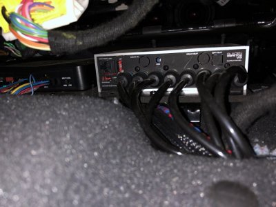

Underneath the driver's seat where I have the Maestro DSR1 and Mosconi DSP.

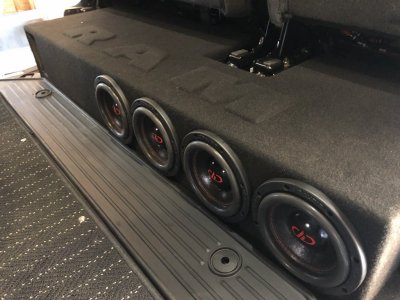

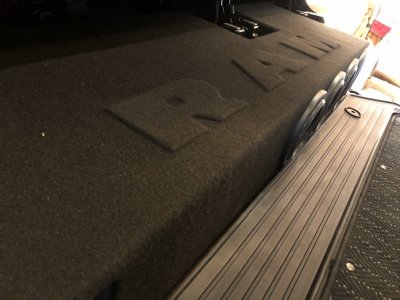

Sub Box from both drivers and passengers side perspectives:
I didn't take a picture with the seat down but even with the seats in their back positions the subs are about ~2" inside of the seat, nothing sticks out.
