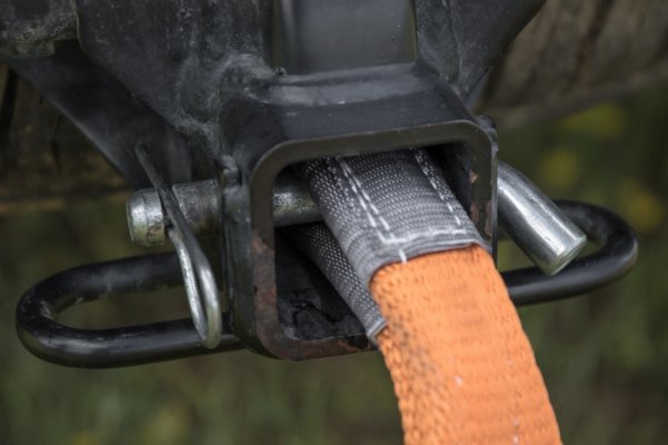

Where u have in the picture looks fine to me

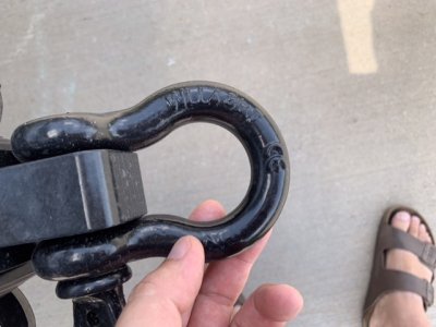

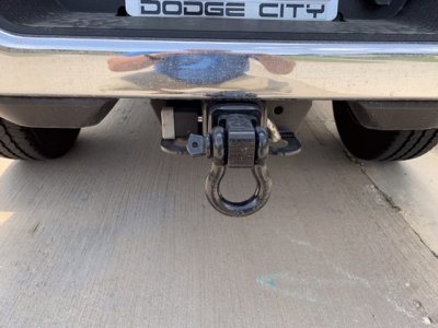

The ONLY recovery point to use in a tow hitch is a D-ring shackle.
The one I keep in my hitch is a solid bar hitch mount rated at 10,000#. The D-ring itself has a working load limit of 4 3/4 ton.
Don’t use cheap shackle either. If you’re stuck and have some cheap ass Harbor Freight “shackle” hanging out of your class 2/3 hitch I’ll let the wrecker handle the recovery.
You do realize all of that weight will be on the hitch pin anyhow? So what the load limit of the hitch pin? Not fussing on it, but unless you drill and put two pins in which some people do, then all of the tow weight is on the hitch pin anyhow.
Good eye. I do realize the weight is held by the hitch pin which many people overlook.
The hitch pin in my pic is a Curt Class V hitch pin with a Road Master lock. All held in place in my Class V hitch, mounted to the frame of my 2500.

A tow rope or chain does not stretch a good recover rope or strap does
It also develops an extreme amount of pulling power
the 5/8 pin alone has 1/2 the strength when used by its self but safer than a trailer ball
