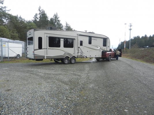

Since the wife and I have a cross country trip coming up at the end of this month I finally hook her up so I could take it to the dealer, I had them to finally put my decal back on from when they had to repaint my front cap and also having them to repack the wheels.
