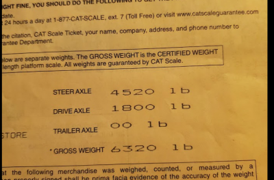

Newbie here, I am trying to solve the towing and payload puzzle. I have a 2016 RAM 4x4 Laramie. I actually went to a CAT scale. This is with my wife and I plus full tank of gas. Anyone notice the front axle is over the GAWR?
WTH??? This truck has NOT been modified.
I don't know what to believe anymore.

Lol WTH steer weight is typically around 3,300 pounds. Something is off. A re-weigh is usually about $2 so just try it again. Cat can weigh 3 axles or sets of axles in one weigh. Center it best you can steer axle on one scale box and drive axle on another.
In the words of Roy D. Mercer. "How big a boy are you?" LOL
I would definitely try to weigh again, as VernDiesel mentioned. Make sure the truck is stopped, and stable. I downloaded the app, so I could make sure they didn't hit the weigh button while I was out of the truck reaching for the call button.
Total weight may be about right, my 2012 2wd 1500 CC laramie weighed 5800 lbs total, never got individual axle weights on that truck without a trailer. Almost sounds like they hit the weigh button before you came to a complete stop, so more weight was still on the front.
