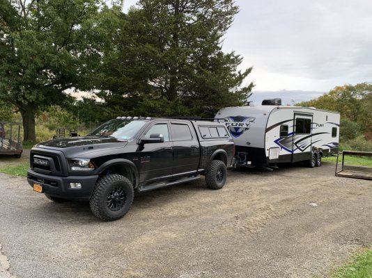

Wildwood FSX 34’ to the ball! 1000+lb TW…8000-9000lb full of water and RZR 900!
Fury 2910, 34 1/2’ to the ball! 990lb TW, @12,000lb full of water and RZR900!
Can’t help with fuel gauge…mine sinks quickly when hauling either! Fury is gone, FSX tows nicer…much lighter!
WDH is a must!!! I also have air bags!
