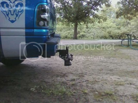

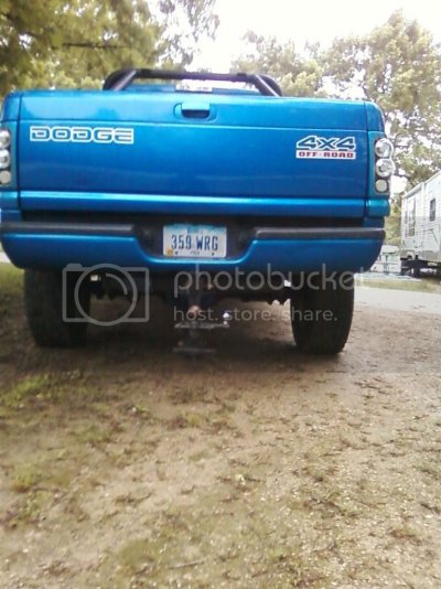

wermbang
Jun 29, 2010
9,724
215
Iowa
2001 Off Road
5.9L V8 Sport
I used an 11" drop hitch for my old camper. My new one sits high enough. My hitch is a Quality S brand, had to special order it. just the drop was $160. this got me a few inches lower than the regular one
