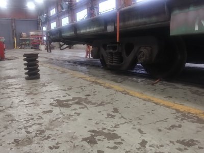

Railcars have used them for a long long time. This one was built in 1969. The standalone one is from even earlier.
I always chuckle when someone says the RAM SUCKS cause of coil springs. The 1500 doesnt suck because of coil springs...but rather cause people made trucks suck and expect them to drive like cars.
