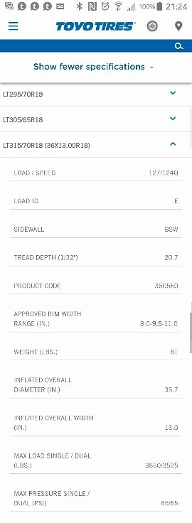

You may have more issues running a 36x13.0x18(315.70.18) than light bumbing.c99bb7bf08bfd862ffa57b5248969906.jpg
