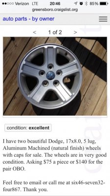

Guys I'm kinda looking on what oem wheels that are light and strong in 17" something I can find on Craigslist. What about these image.jpg

Chad, those are the Durango wheels that lots of guys use. On that wheel, I wouldn't go bigger than the M&H 275/50/17's though. That is the same tire Travis is running on his crew cab, and he is cutting low 1.7 60's and high 12 second 1/4 mile times.
If you want to step up to the 325/45/17's or a set of the Hoosier 28/10/17's, then you want to go with a 9" wide wheel. I am running the SST wheels myself. They look great, and are the perfect size for the Hoosiers.

All good info! Here I think I'm going to contact this guy I belive I can get them for a bill maybe a little more. I'm wanting that ati pulley next too!
Hate to put a lot of money in the wheels,slicks consider it be just for the strip use only and that be rare that I go.
