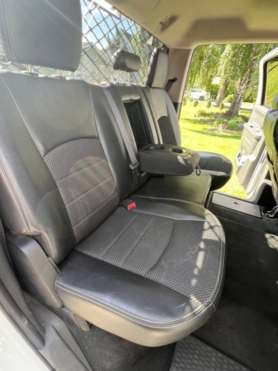

Well guys I got them all figured out and installed and everything work. Thanks for the help was able to just transfer airbags and seat belt buckle from the old seats to the new seats with no issues. I did have a plug under drivers seat that had power so was able to take those wires out of the old plug and add them to the exsisting plug and everything works. Very happy with how they look and how comfortable they are… everyday turning my tradesman into a wannabe Laramie!!!!. Now the next project is to do the remote shifter to install the full center console!!!!IMG_0489.jpeg

Well guys I got them all figured out and installed and everything work. Thanks for the help was able to just transfer airbags and seat belt buckle from the old seats to the new seats with no issues. I did have a plug under drivers seat that had power so was able to take those wires out of the old plug and add them to the exsisting plug and everything works. Very happy with how they look and how comfortable they are… everyday turning my tradesman into a wannabe Laramie!!!!. Now the next project is to do the remote shifter to install the full center console!!!!View attachment 567784
Looks great! It's fun to find the upgraded parts and install them to a base model. I started with a 2014 Express and now have a 2014 Ramforum Edition!

So I had manual seats but my truck was wired for power and other stuff under the seat. My biggest issue was the air bag plugs were different between the seats. So I ended up taking the fabric back on the seats and using my original air bags in the new seats. Then I just found the positive wire and wired it in so the power seats worked.
