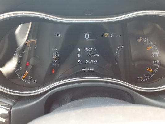

Was in B.C. earlier this week and went car chopping with my buddy. We took a brand new 2021 V6 3.6 litre Jeep Grand Cherokee for a test drive. Penticton to Kelowna return vehicle computer showed 25.6 Imperial MPG. Speeds vary quite a bit from 50 to 100 KPH. We weren't able to cross verify by hand calculating. We did however have my 5.7 litres V8 2020 Grand Cherokee to compare to. This was the first long highway trip we have taken the Jeep on, most of its miles are around town as my wife's daily driver. On the trip out, the V8 was showing 30-33 mpg on flat ground at 110 to 120 KPH. Hand calculating over the distance and each fill resulted in 1.0 Imperial mpg less than the computer was providing. Playing Ricky Road race in the hills and corners of B.C., computer was showing me 26-28 mpg over various fills. Again, hand calculating was 1.0 mpg less than the computer was recording. By all appearances the V8 gets as good or better mileage than the V6 option. Both vehicles were running exactly the same Perrelli Scorpion 20" all season tires. I believe the higher torque at lower RPM as well as the 3.04 rear end in the V8 versus the 3.54 in the V6 is what makes the biggest difference.
Chrysler gas mileage published for the V6
Hwy 9.6L/100 KM (29.43 Imperial mpg)
City 12.7L/100 KM (22.24 Imperial mpg)
I find it interesting that such large and powerful vehicles can get such good gas mileage. I have never liked small, or under powered vehicles. Gas mileage gains will never sell me on the idea of driving smaller cars.
Mileage from Edmonton to south of Calgary, including some city driving through Calgary for lunch and shopping. Recorded on the Trip A side. Tank holds 100 litters, used just under 1/3 tank in 386 kilometres. Provides a range of about 1200 kilometres per tank.

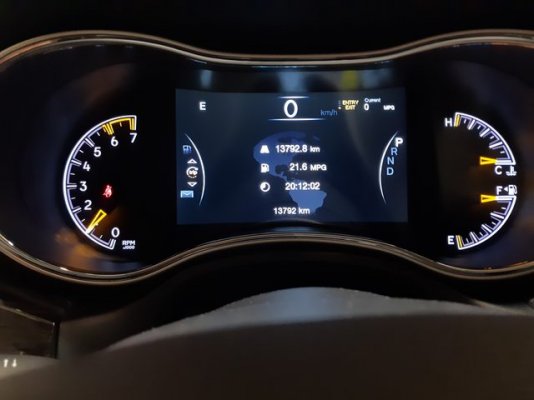

Gas mileage for a combined 13,792 klms, 98% of it in city driving. Recorded on the Trip B side, used for aggregating overall mileage to date. Hour counter goes to 99hours.60 minutes.60 seconds and resets to zero.
