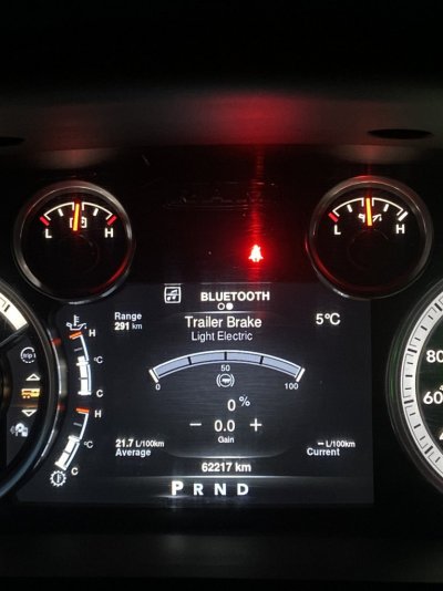

Hello everyone, today I installed an OEM trailer brake system in my 2013 ram 1500 sport. The system was given to me from a 2015 sport. I used alpha obd to program the new module. Trailer brake is an option on my dash, but the + / - gain or slider is not functional. (Also no options in 8.4 u connect)
My only options in alpha obd are
-CBC Features : Trailer Tow Present
-P/T Chassis net : ITBM/HWM Integrated trailer brake module
Any info helps. Thanks in advance

If the OEM brake controller came out of a '15 then it's the wrong one for your '13, the one used in a '15 is only for that model year.
These are the part numbers for the OEM brake controller kit by model year:
2013/14 = 82213474AB
2015 = 82214492AB
2016/17/18 = 82215040AC

Damn, thank you. Is it only the controller? Will the switch work in my truck?

Without comparing part numbers, I would say it's probably just the module under the dash that's different, the dash slider is probably the same
