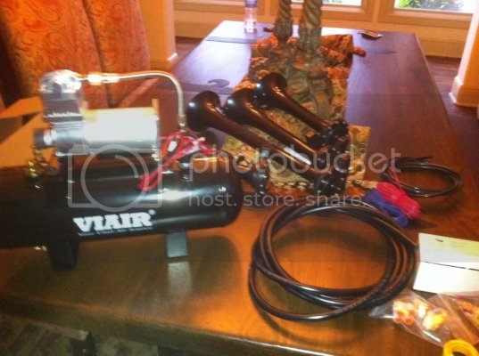

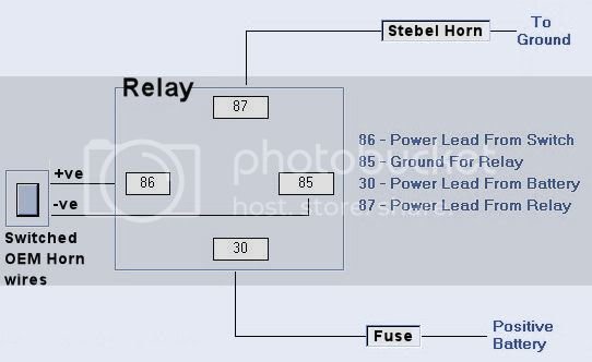

So, ordered my train horn today and it will be in Friday. I want to set it up myself. Just wondering how difficult this will be, and if there's anything I should know before I start getting into this about placement, tubing, wiring, etc. Also, how would I go about wiring it to change with the stock horn?
