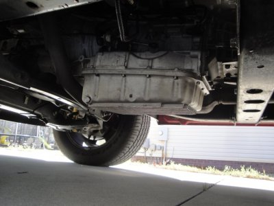

Went to a PML cast pan with cooling fins. I was looking for max cooling with this and a 1 ton cooler.

Looks very nice does it reduce your clearance by much??

Not at all, the pic is misleading. It's still above the lower control arms.

Isn't there a potential to "over cool"?
I guess the potential is always there, but not likely. I would say overcool would be if you could keep the temp down low enough that the trans computer locks out OD until it's warm enough. I haven't had any problems yet and it's nice to have when towing long distance or hauling stuff.
