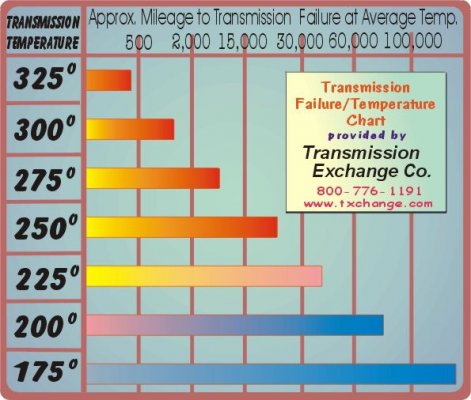

Also a trans temp general guide.

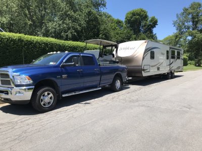

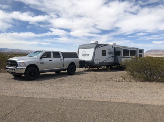

Picture of my set-up just because.
And videos as promised.

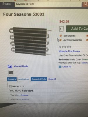

i just ordered this i’m going to put inline with my factory cooler so i’ll have 2 trans coolers
