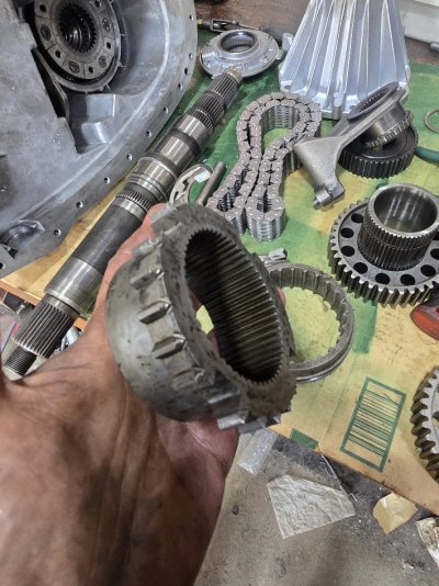

Its a 2 hour job and 300$ for a rebuild kit. WTF are those guys doing. :birgits_tiredcoffeeIve never worked on a N271 before last week, and I was able figured it out. :anitoof:
And reading all the issues with the n273 im glad I choose the manual version for my build.
Its either one of the gears chewd up and got stuck, a c-lip that fell off. or the selector inside somehow got jammed.
