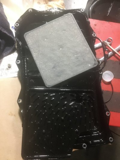

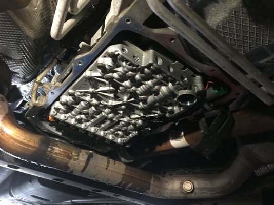

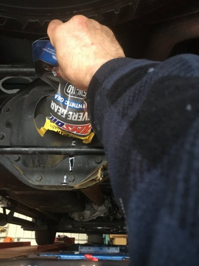

After watching Weber autos you tube vid of a wheelchair bound mechanic do it.Plus I heard of instances of it being low from the factory so I did the front dif. transfer and rear dif.with the trans.at 10k all amsoil with a factory pan that came with fasteners built in filter and an extra gasket. Checked it at temp 3k later and it was good.Can’t wait to get rod of the crossover when the headers and exhaust is done.EC98F320-60C7-41F0-98AA-D1B882C9E670.jpeg01C02218-A038-4D9B-B3BB-4BD08A79BC05.jpeg035A178C-A4E3-436A-9B99-208562891B67.jpeg

After watching Weber autos you tube vid of a wheelchair bound mechanic do it.Plus I heard of instances of it being low from the factory so I did the front dif. transfer and rear dif.with the trans.at 10k all amsoil with a factory pan that came with fasteners built in filter and an extra gasket. Checked it at temp 3k later and it was good.Can’t wait to get rod of the crossover when the headers and exhaust is done.View attachment 506212View attachment 506213View attachment 506214
got to check that out, sounds inspirational. real cool
