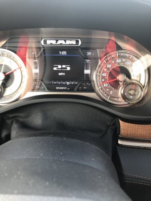

I have a 2019 longhorn with ecotech hemi and tranny has been doing weird stuff since new. In shop at least a dozen times and not fixed dealer has had truck since january 29th trying to replicate issue before doing anything. The tranny when coming to a stop will go into maual mode all by itself usually 1st or 2nd gear not drive like it should be. Anyone else having this issueIMG_1978 (3).JPG IMG_2008.JPG

I have a 2019 longhorn with ecotech hemi and tranny has been doing weird stuff since new. In shop at least a dozen times and not fixed dealer has had truck since january 29th trying to replicate issue before doing anything. The tranny when coming to a stop will go into maual mode all by itself usually 1st or 2nd gear not drive like it should be. Anyone else having this issueView attachment 196954 View attachment 196955
Fortunately mine is not doing that. You might try checking in the 5th generation forum.
