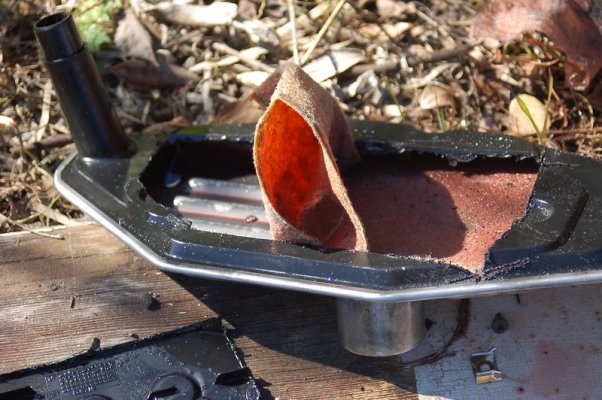

It's a sump filter and the oem is synthetic. Cut mine open after ten years, still fresh and pliable. My canister was shot.
