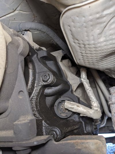

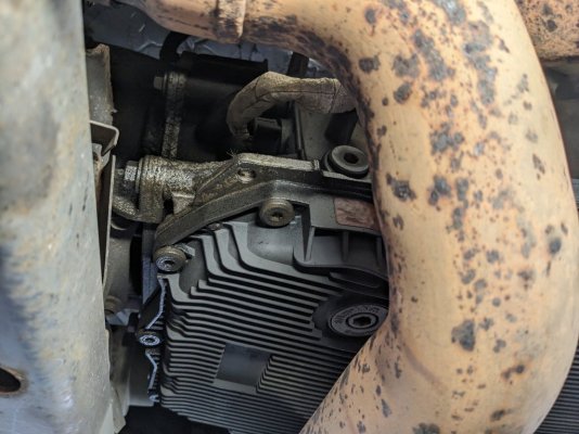

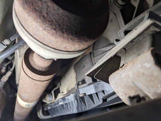

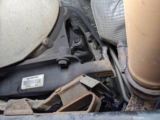

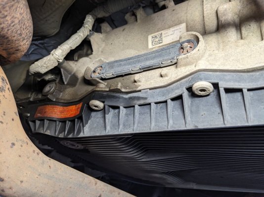

My 2015 RAM 1500 Sport seems to have developed an oil leak around the transmission area. I can't quite pinpoint the origin of this fluid and whether it's a failed gasket between the transmission pan and housing, or whether this could be originating from higher up. Based upon the attached photos, could I please have some assistance from better trained eyes as to what could be the cause of this leak?

Thanks for the reply, @Daw14. I've cleaned the area down today and will monitor over the coming weeks. Definitely not an overspill and the underside was bone dry last time I inspected the underside, a month ago.
Do you have the 5.7 V8 or 3.6 V6 engine? I ask because the 3.6 has the oil filter housing/cooler in the valley of the engine between the cylinder banks. It’s known to leak and drain oil and or coolant down the back side of the engine onto the bell housing leaving an oily mess underneath the truck.
That's a good bit of information to know, thanks! However, I have the 5.7 V8.
