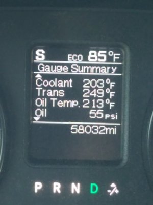

Here are the readings from just driving home a little "spirited"

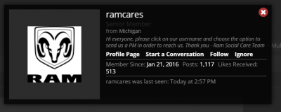

Jasmine - there is not a "direct message" option. There is a "start a conversation" option, which I did, but no way to PM you.

So I was driving unloaded (nothing in bed, no trailer) around a neighborhood slowly Saturday and again, the transmission temp got up to 248. This just doesnt seem normal when the warning light is only 25 degrees away. If I had kept driving slowly around instead of finishing my task and getting back up to road speed, I'm wondering if it would have overheated again.

You were correct earlier...select RAMCARE and "start a conversation"
