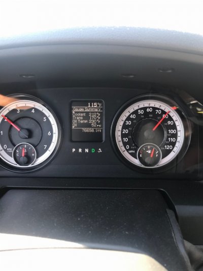

Go back to the dealer and tell them you're seeing 240F in your trans temp and that's not not normal, it may be normal for engine oil lol, but not for the trans.
Show this picture to the dealer. That was with 700lbs in the bed and the whole family of 5 inside the truck.
