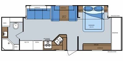

Thanks everyone. We are looking at a number of bunkhouse travel trailers that will allow us to have room and have room for our three dogs when camping (they get the bunkhouse). Primary candidate is the
Cougar Half-Ton 29BHS. Dry weight 7008 lbs, hitch weight 765 lbs. Perfect layout for us and most important the wife loves it.

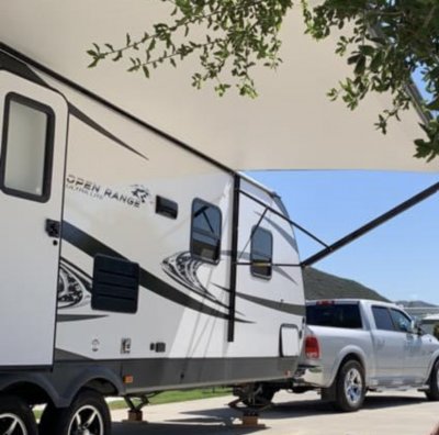

So funny...we have 3 dogs and also debated a bunkhouse but found a deal on a rear living. Open Range 272RLS. Love the theater seating and big couch...and the dogs do as well!

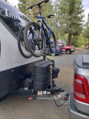

I tow an Imagine 2150RB @ 6400 lbs 28 ft long using an Andersen WDH. I get 10 mpg towing and 18 mpg around town not towing. It is a 2019 Ram 1500 Limited 5.7 E-Torque 3.92 rear end 4X4 and it has air suspension. I have gone from Vancouver Island, BC to Bryce Canyon, Grand Canyon, Moab Utah, Mesa Verde, Crater Lake, Sisters Oregon and never experienced any towing difficulties such as sway or bouncing or problems going up hill or down hill.
This is by far the best truck I have ever owned, also the Imagine is an excellent travel trailer.
