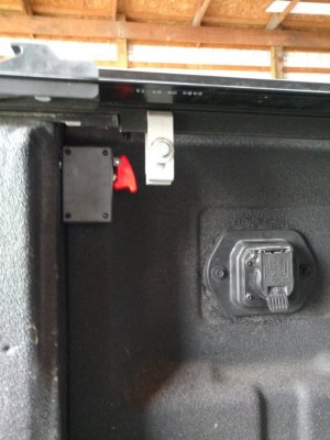

I use waterproof LED tape lights in the bed of my buddies 2500 w/8' bed. I tapped the +12V from the trailer 7pin plug. Mounted a small plastic box using 2 sided 3M VHB tape that had a fuse and a safety switch.
I cleaned the underside of the bed rail really good with isopropyl alcohol. That was a couple of year ago, still work good and no problems with them peeling off. He says it works good to see his fiver hitch.
I'll second putting the switch in the back vs using the cab switch.IMG_20161016_154627986.jpg20161016_194154.jpg
