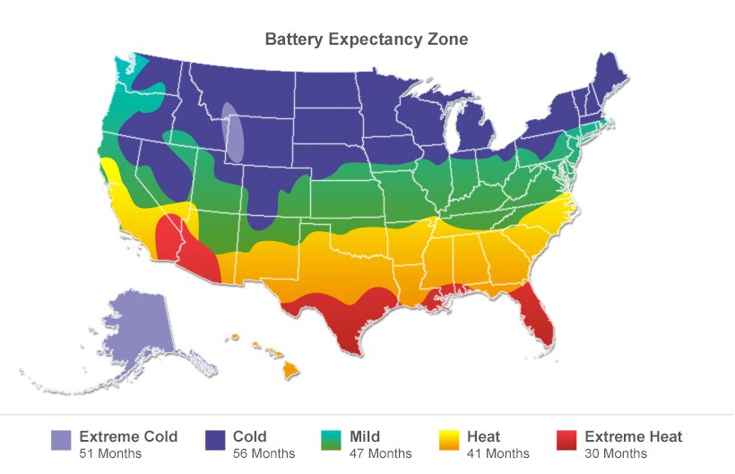

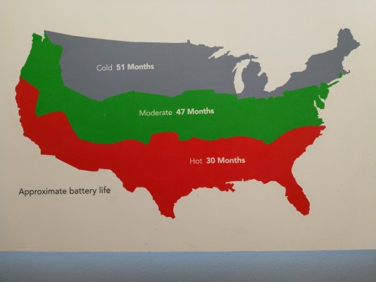

If it is 2013 you have a win module, you can bypass to check if it is win module. Not sure when they got an rf hub, 2014? In Florida battery life is very short, if the battery is over 3 years old past due anyhow.
